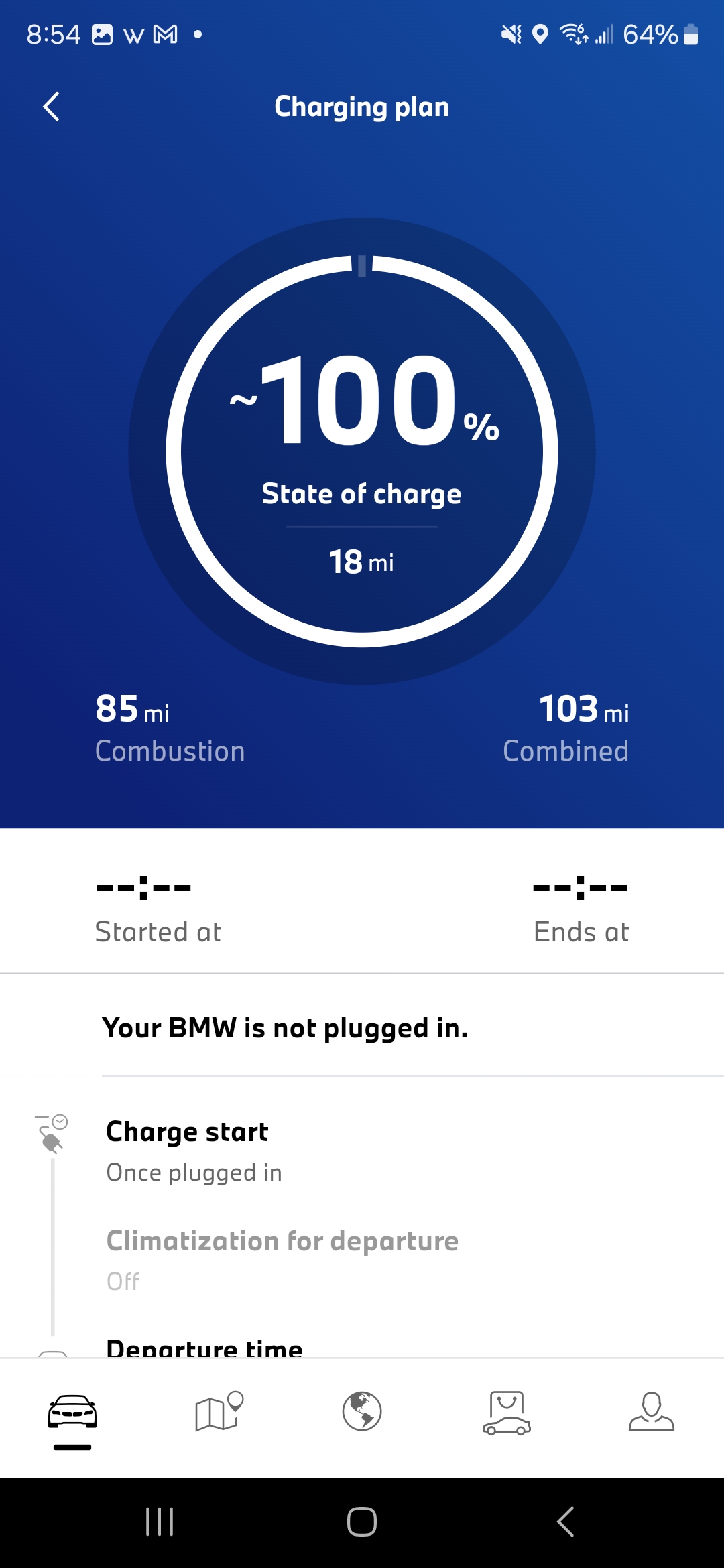

My 2019 Coupe has also stopped. It does give me the correct battery percentage; but does not tell me if the car is charging.

My BMW app just started working again with realt time charging updates.
I just happened to check the app now and it had me re-enter login credentials.

Hadn't updated since October 21sh then randomly, I had to re login and nee date with real time updates were shown....

In the mean time the people at BMW Romania replied to my e-mail and proposed a “temporary” solution consisting in updating the BMW Services from the ConnectedDrive menu…which surprise suprise didn’t change anything 😅
After I informed them that there are no changes and the car is still displayed as Unplugged while charging they asked for the cars VIN and told me that the tehnical departament analysed my case and it seams that all of a sudden it’s my cars fault because : “the car is not sending records regarding the trigger of car’s charging” whatever this means…They told me to do a factory reset on the car in order to try to solve the problem…which I will not do because I will have a few mods on the cars ambiental light and other things that I will get erased…
I don’t understand how can it be the car’s fault and all of sudden the car is not sending data anymore, just after the app has been updated… before with the older app version everything was perfect.

Its our car and the App. My i8 last updated its charging history in October 2024 similar to migsgig. I re-logged into my App and it states my car has an updated status from today, but does not show any charging history or that the car is currently plugged. It just states "all good."
