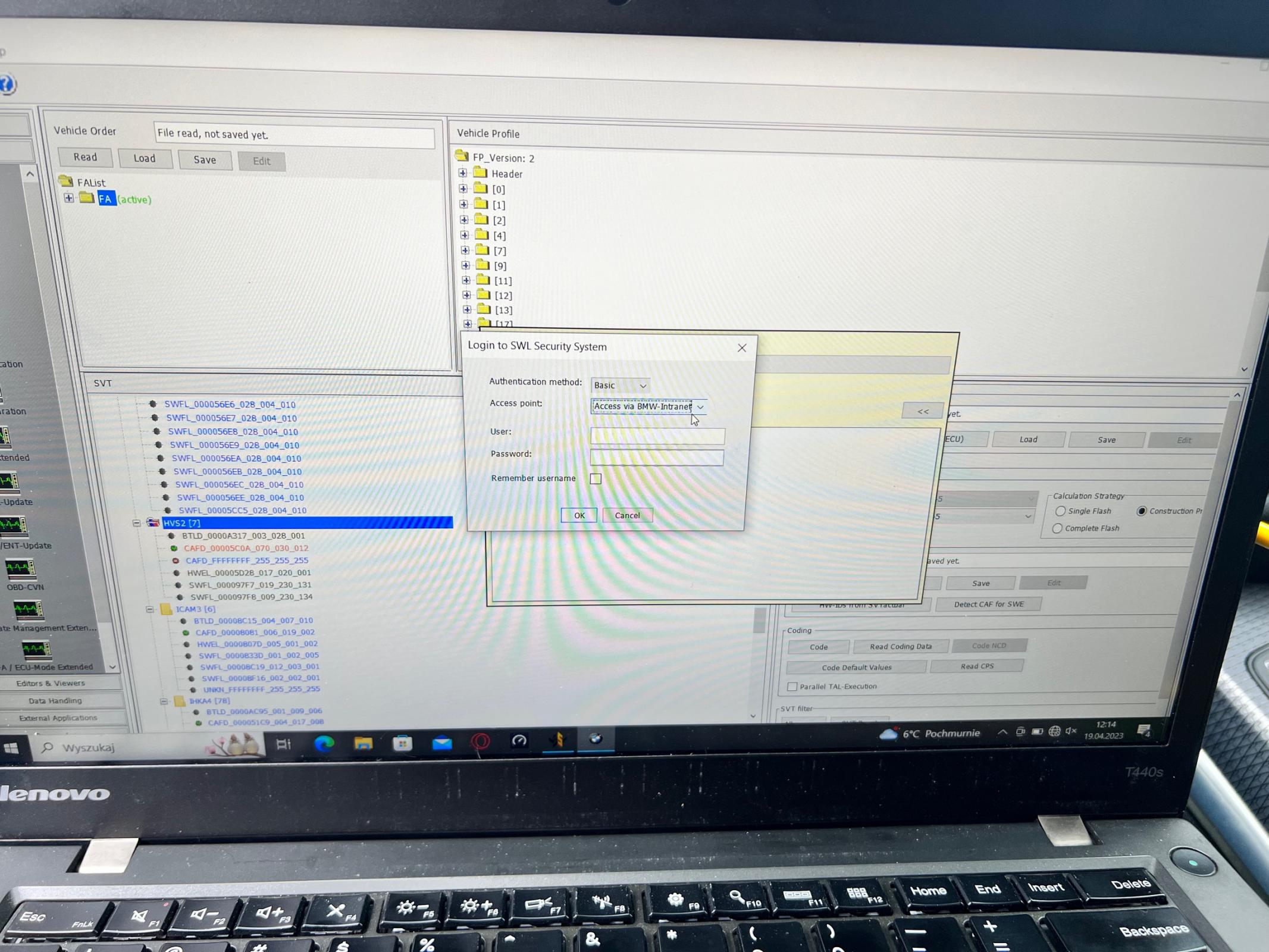

everything is possible, after many. researches, I was replace HVS, but actually it isn't DIY, because after replacement we have to code it. Offline coding is not working because this module have coding 2.0 i think. Finally my i4 was woke up by ista online, I've programmed this module to my car and now everything is working.So for anyone who will be follow like me, if you don't have access to ista online you have to go to local dealer to program this module.

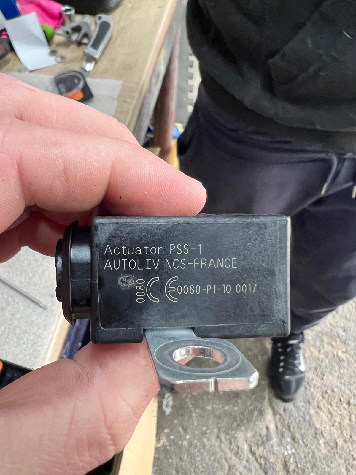

About 1,8k$ but I have access to AOS online 1 day of session costed about 30-40$. Programming in authorized dealer costed about 300$. Actually i was replaced SME module by myself so we have to add cost of assembly and disassembly battery.
Why I was replace SME? Because inside of them we have 2 pyro fuses pss4 and pss1, actually I think thats regenerationable so if someone will decide to renewal probably will be cheaper.

In my case I have to replace sme becouse some of transistors inside module was broke.I want have a calm head, because I don't trust regenerate parts which is responsible for battery. I think that cost of 1.8k$ isn't big investment in 100k$ car.
Actually you have to replace SME, code and programmed it and replace fuse in front of battery. That's enough in case of battery. Every service who make it now hate me Sorry guys but I love share knowledge with others
