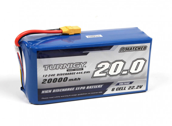

meh, yank that LiIo junk out of there and fill it with LiPo's, your car will fly like a rocket!!! lol
