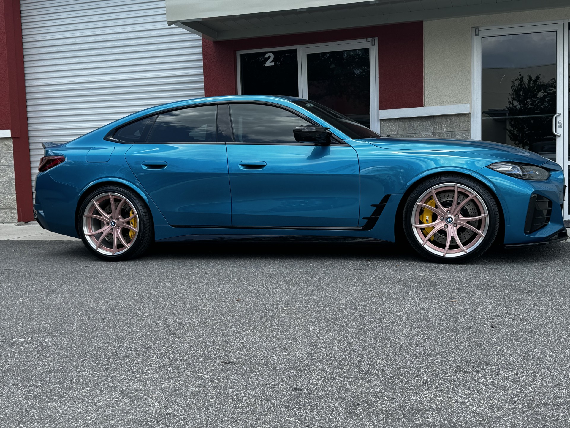

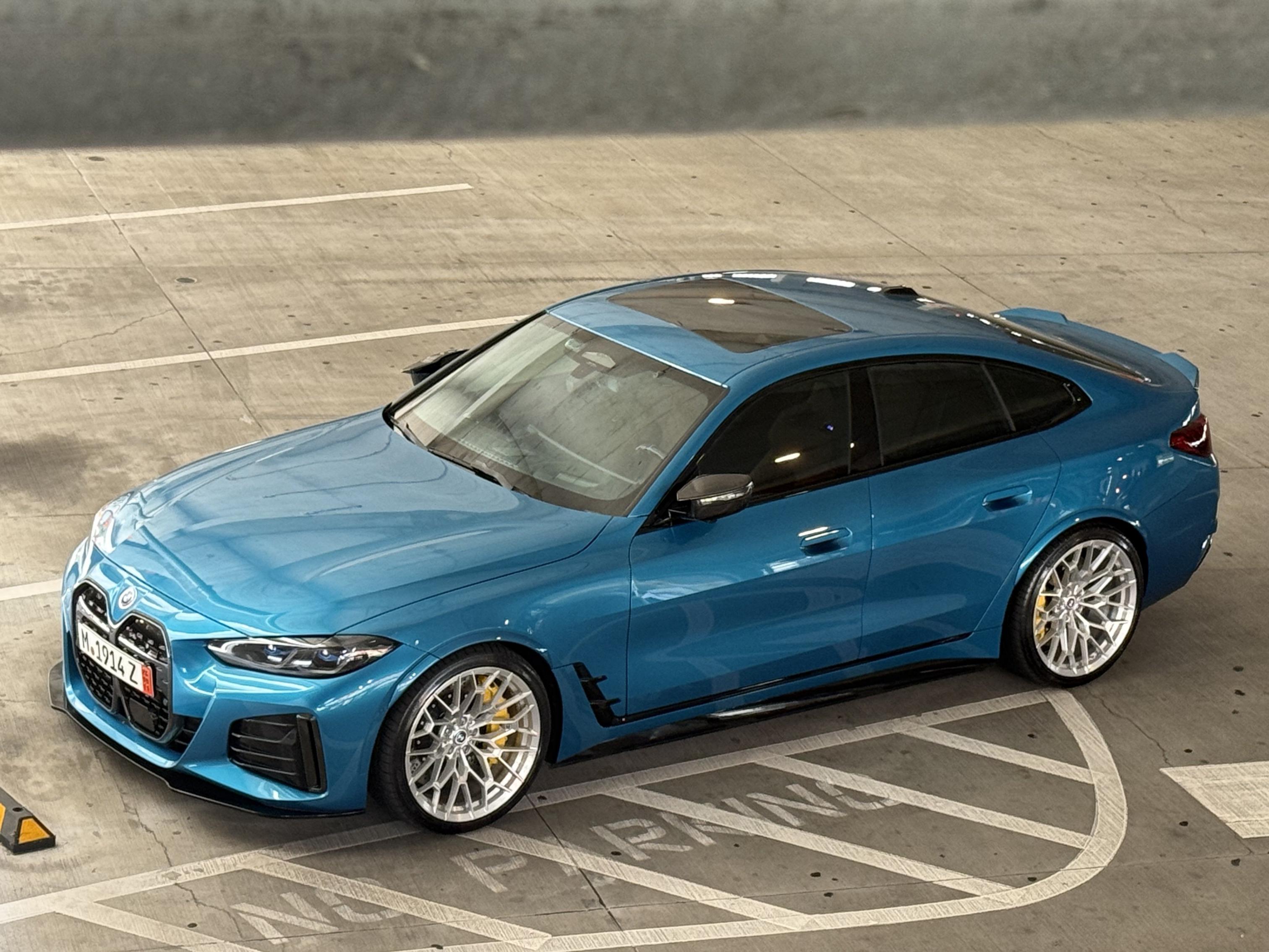

There are no problems with these wheels.
What range do you get with your custom wheels (winter, spring, summer, etc)?
Why Not?
      04-24-2024, 02:29 PM   #46
We are getting about ~260 miles of highway range (ECO Pro, 70mph, 45psi all tires) with a squared 255/35R20 all seasons setup, with the rear spoiler, front lip, and on Eibach springs. No real winter in Florida.
Nice. that's just about what I get from 19" all season on my M50

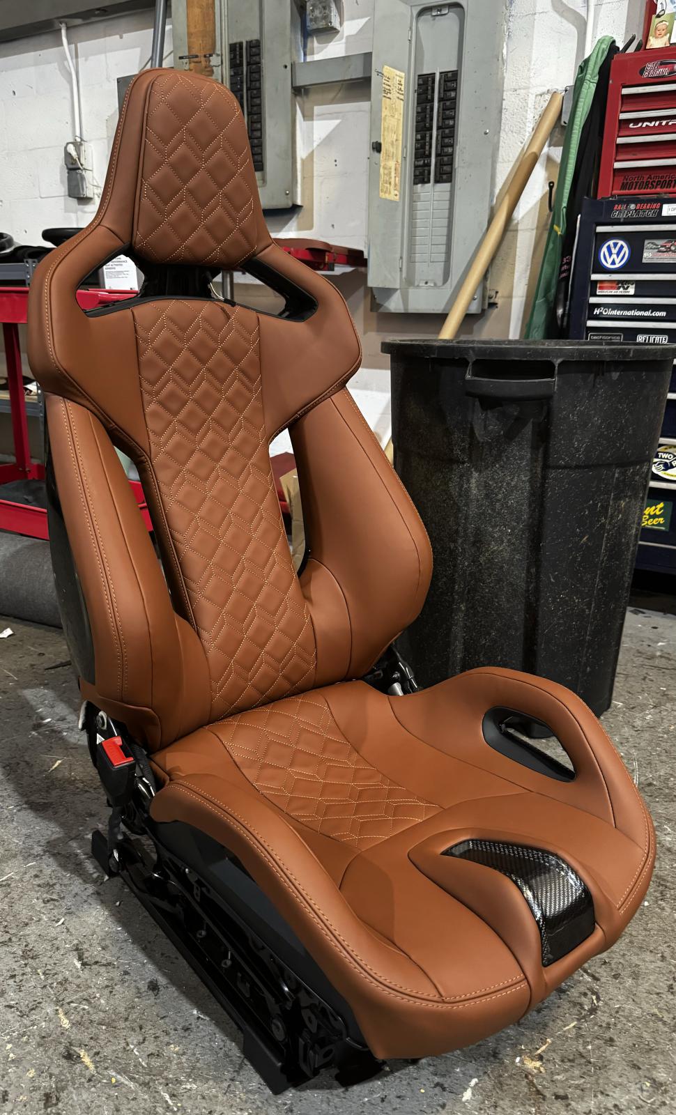

      05-24-2024, 12:40 PM   #51
OEM Tartufo buckets in production..

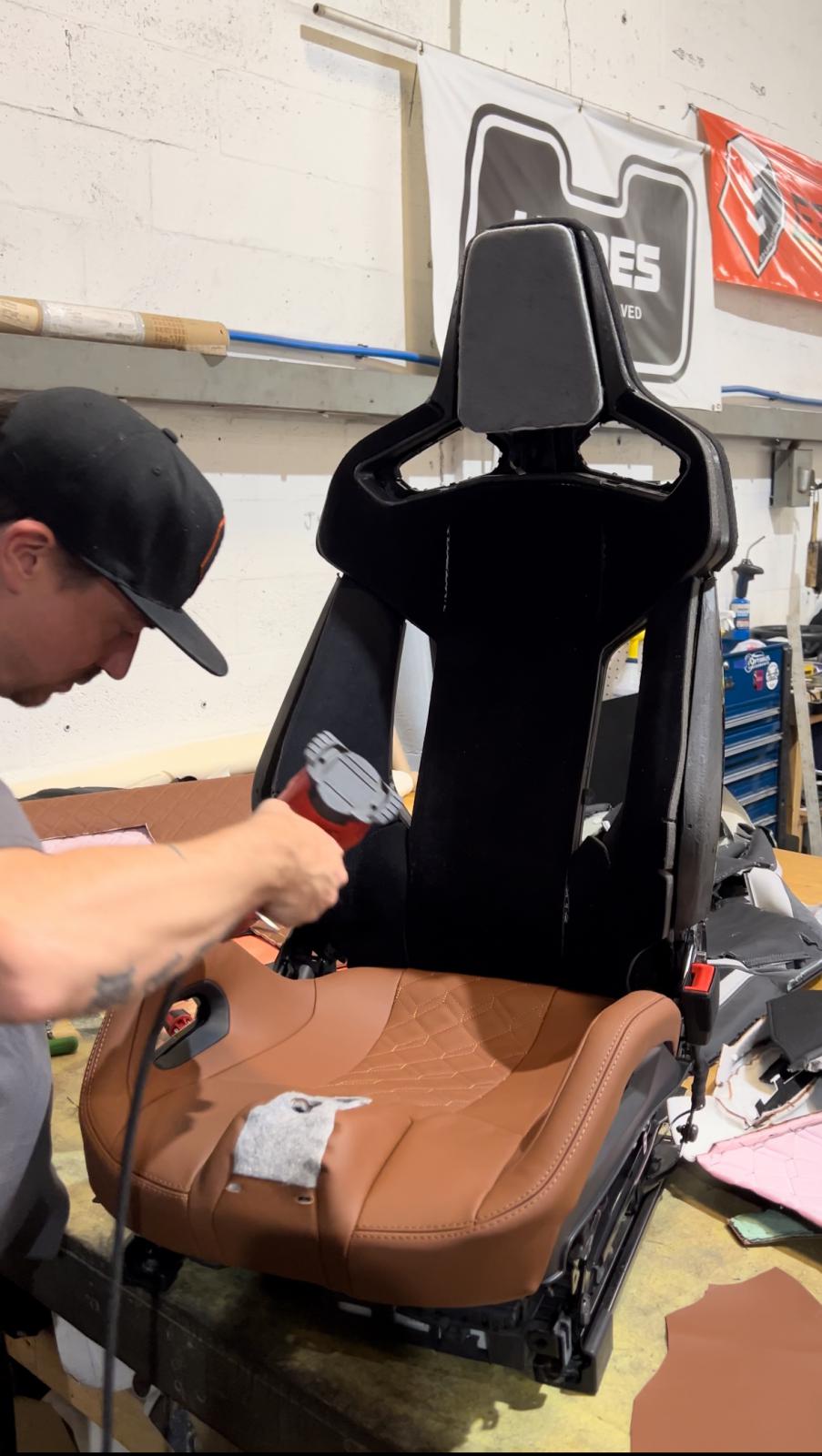

      05-31-2024, 11:50 AM   #52
One done, one to go…
      05-31-2024, 05:36 PM   #53
Poleposition
Poleposition's Avatar
618
1,475
Drives: very well
Join Date: Sep 2008
Location: NY
wow. what a project. Following. Good luck

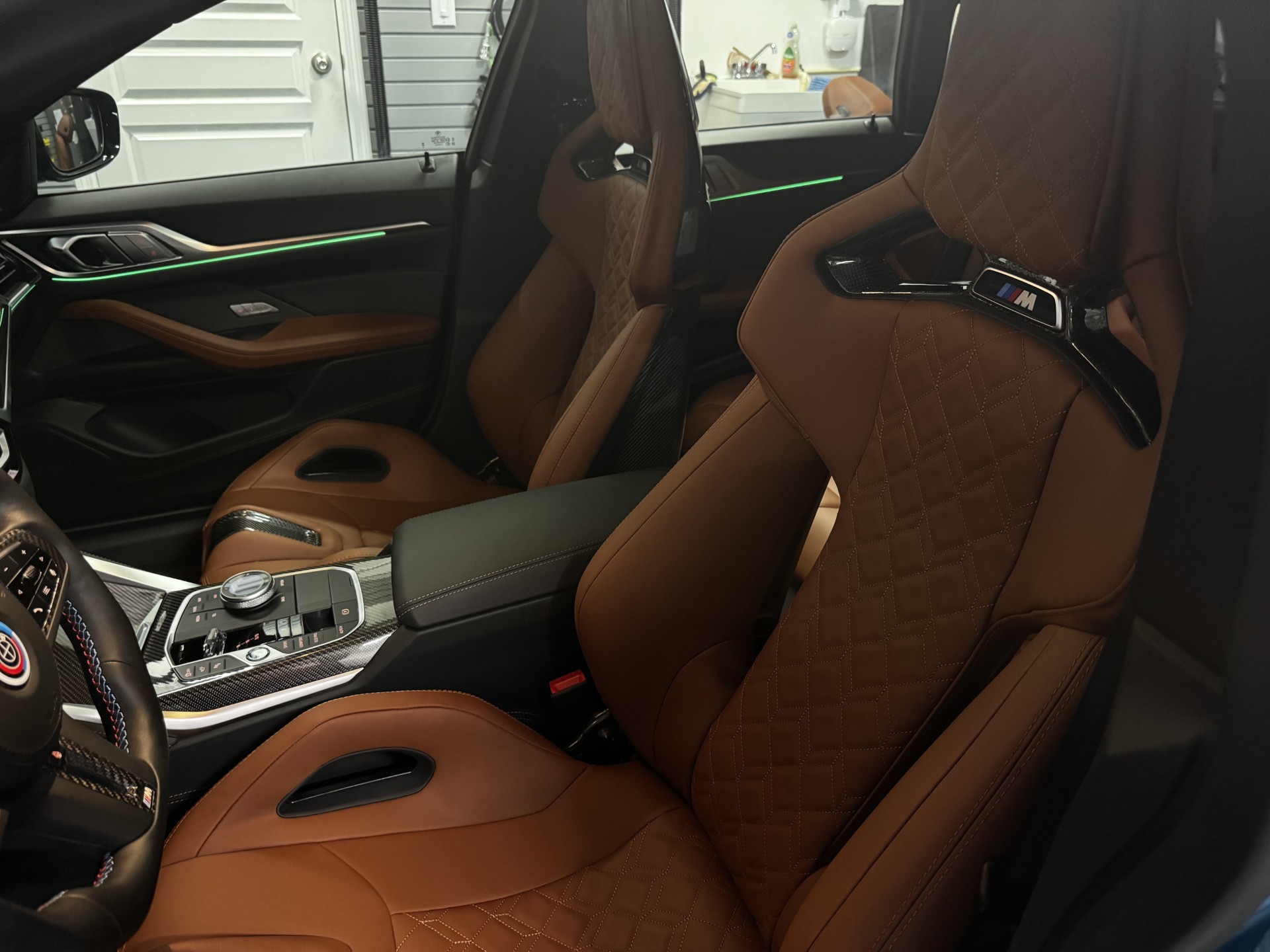

      06-04-2024, 08:53 AM   #56
… and done.
      06-06-2024, 07:19 PM   #57

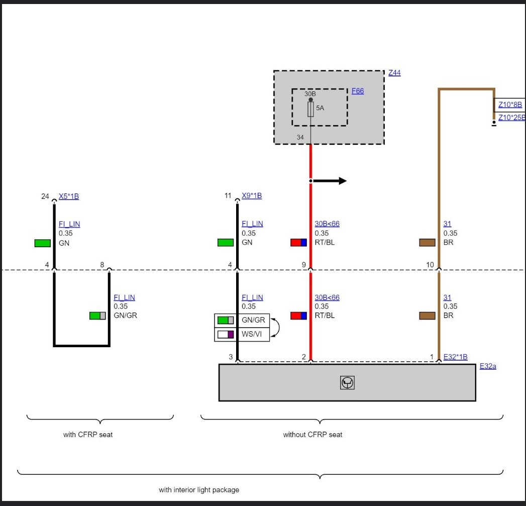

Carbon buckets swap from non-ventilated Sport seats in 4 steps:
  • Add 4 wires (X12*B): K-CAN +/- (pin 5, pin 6) to passenger controller*, +12V wire (pin 7) to power ///M badges to each seat controller
  • Remove/isolate wire from pin 4 (LIN) in passenger seat controller (X12*B) - Carbon buckets have no footwell light.
  • VO Coded 48C (Carbon Buckets), remove 481(Sport seats) or 712(M Sport seats), and 488 (lumbar) via BimmerUtility
  • Enable occupancy sensor on passenger controller via ISTA (clear any airbag error)
OEM integration, fully functional.
* ventilated seats, or M Sport seats have controller on passenger-side, CAN wires are already in there so no need to add CAN wires.

      08-09-2024, 09:13 PM   #62
Igor_M5
Igor_M5's Avatar
2486
2,039
Drives: Many, BMW.
Location: New York City
iTrader: (11)
2009 E90 328i   [10.00]
2007;2013 E91 335is  [10.00]
… and done.
Amazing craftsmanship, seen many attempts to reupholster and all looked like chit. You found a 👌tailor.

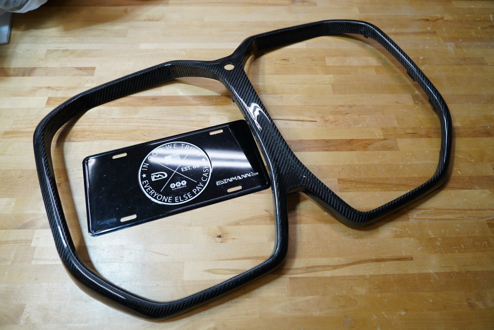

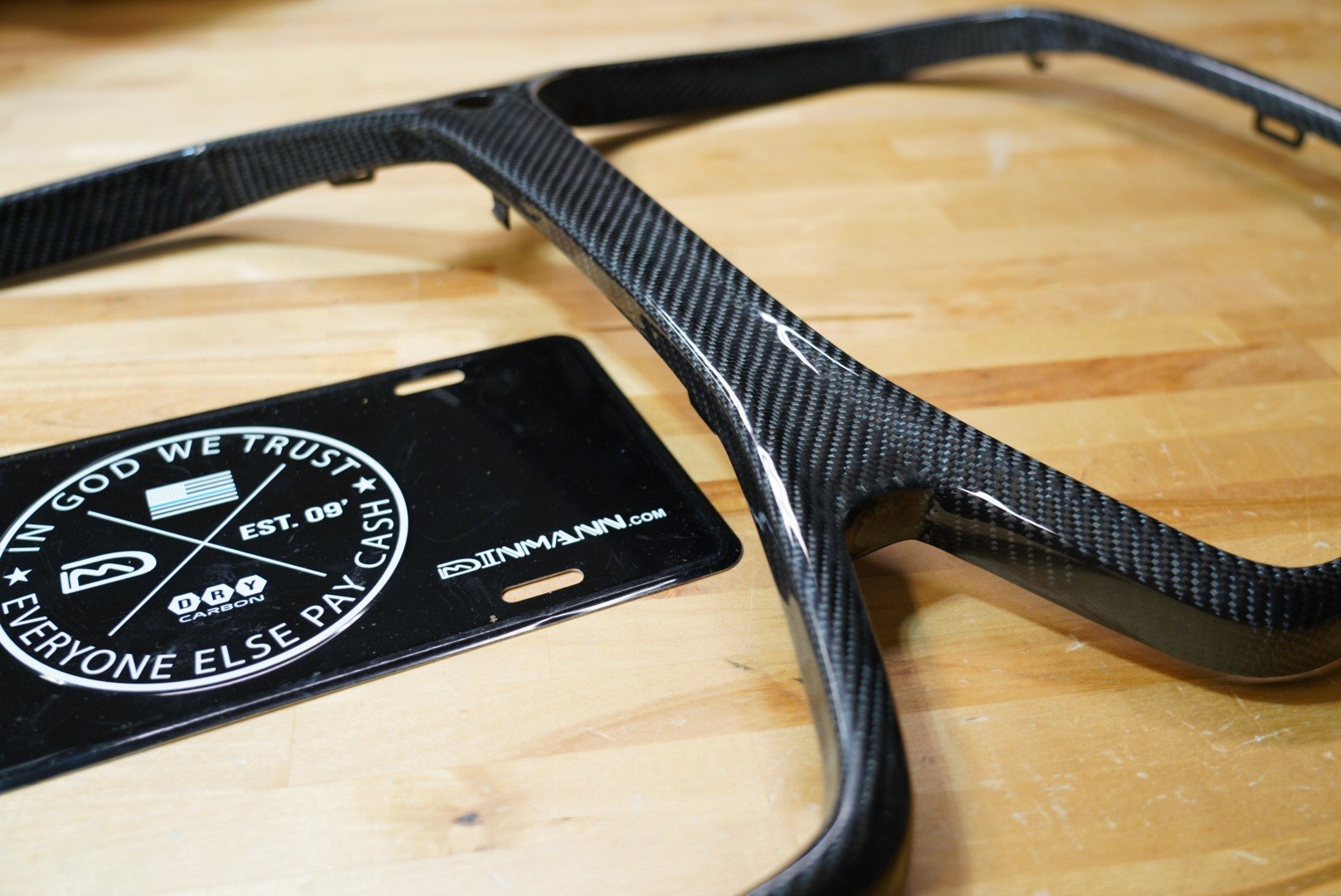

Not enough Carbon...
