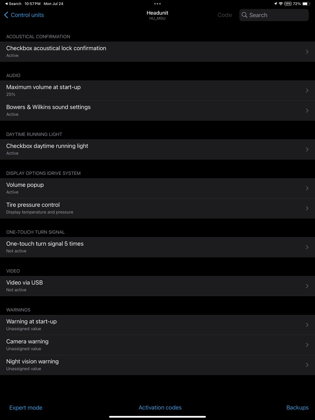

One is $20 and the other one is $100. You’re rather limited on what you can do on these vehicles going back to the original post on this very thread. Bimmer utility is more powerful, but not on this vehicle. Not enough modules can be programmed with the new architecture.
Here is the list of things you can change on the head unit module with BimmerCode. You can go into expert mode to do more stuff, but there’s not enough modules available to program like with previous vehicles.
