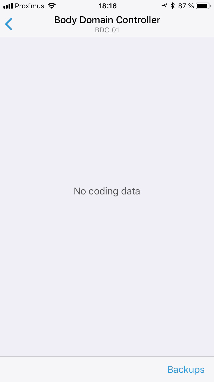

Ecu Board Display Control locked
Hello everybody.
I'm leaving in Belgium. I'm the owner of a Bmw I3 2015with Rex. I'm very happy of my car and won't go back to a thermic car.
My i3 has been recalled by BMW for both reasons. Fist : update of the electronic box, Second : for the Rex (verification of the installation). It is an official recall from Bmw Munich.
I already have coded my car with bimmercode and iCar. But since this update, I can't modify the Ecu BDC. It seems locked. After initializing, all Ecu are green but the BDC stays in grey.
I can't do nothing. I'm desesperate. Does anybody know what's the problem ? I've the last bimmercode version downloaded 3 days ago. I can modify others Ecu. My iCar is in order. I don't know ??
I can't speak for "bimmercode", but the proper BMW e-Sys coding requires periodic updates of PSDzdata configuration files. Especially, after a new version was download to the car at the dealership.
More info here:
http://www.bmw[deletethis]coding.onl...ownloads/esys/
Sorry about [deletethis] insert - this forum is jealous of external links, and garbles them up.
