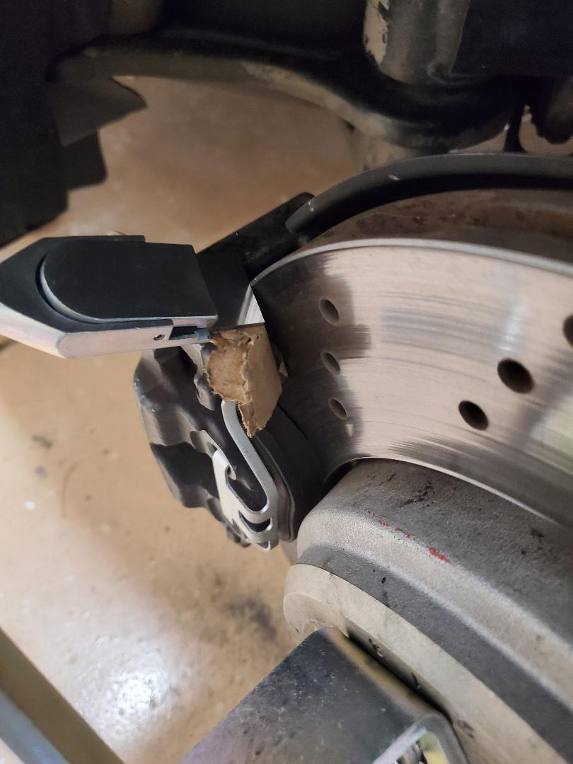

M rotors are much softer than the normal rotors. This means the rotors tend to wear more.
This is one of the reasons that the M rotors get large lips on the outside edge where the pad doesn't extend all the way to the edge of the rotor (and in some cases a bit of a lip on the inside edge). Making things worse most shops won't turn the rotors because they are two piece and tend to flex and chatter so they can't turn them correctly....
I wonder if the min thickness is really as much about the lips that the pads create as it is about a real safety factor....
I found a tool that can be used to remove just the lip "laser tools 7839." With that said it isn't easy if you have a larger lip... I removed a .5mm lip from my rear M3 rotors. It took quite a bit of force (especially with the limited slip requiring both wheels to turn) and wasn't exactly easy to turn the crank and hold the tool with one person. The dust shields are also in the way and had to be bent back or removed to do the job. Care was also required to make sure that the tool is held only over the lip so that the rest of the disc isn't scored. I did touch the disc slightly a couple of times but fortunately it just shined the surface inside of the lip (it would be easy to gouge the disc).
I only used it on the rear rotors because my fronts were almost new, I would probably not be as "cheap" on the fronts and would just replace the rotors but for the rears I was willing to give it a try.
The tool is from a UK supplier and I had to buy it on ebay. It isn't cheap so it I wouldn't recommend it for a one time use. I would also use it when rotating tires to knock down the lip regularly rather than letting the lip get large where it is a lot of work to remove (and a big arm/shoulder workout)...
Outer Lip removed (Inner wasn't done yet):
Name:  rotor lip removed 2.jpg
Pile of shavings:
Name:  rotor lip removed metal pile.jpg
If I did it again I would remove the pads and probably the dust shields to get better access but I got it done in a couple of hours (it takes more time than you might think to hand crank the wheels. The worst part is where the crank overlaps the cutter making it hard to cut that portion so it is necessary to move the crank to a few different positions during the process.
-Rich
