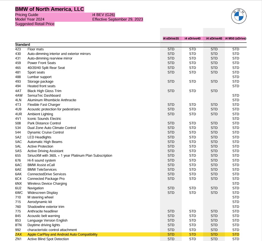

Hello,
I'm not sure what region you are located in, but the i4's in North America have Apple CarPlay/Android Auto listed as being standard. Down below is a screen shot of the MY25 and MY24 pricing guides and you'll see ACP/AA listed as Standard Equipment!
Name:  Screenshot 2025-02-23 023243.jpg
Name:  Screenshot 2025-02-23 023309.jpg
I hope this helps, but I assume you might be in a different region/location, but I would be mindful of my vehicle's warranty and/or the possibility of a Software Upgrade completely wiping out a retrofit.
Best,
Cameron
PS - Android Auto(in North America) is actually blended in with BMW's Bluetooth System and BMW's Bluetooth works quite well in my opinion, however I am an iPhone user lol

Originally Posted by Cam330i View Post
Hello,
Attachment 3673293
Attachment 3673294
Best,
Cameron
I am in New Zealand and this functionality comes here standard too hence my assumption this car had. However apparently this was some special build where they didn't include this functionality for whatever reason. I took it to the BMW service and they also confirmed it doesn't have it.
