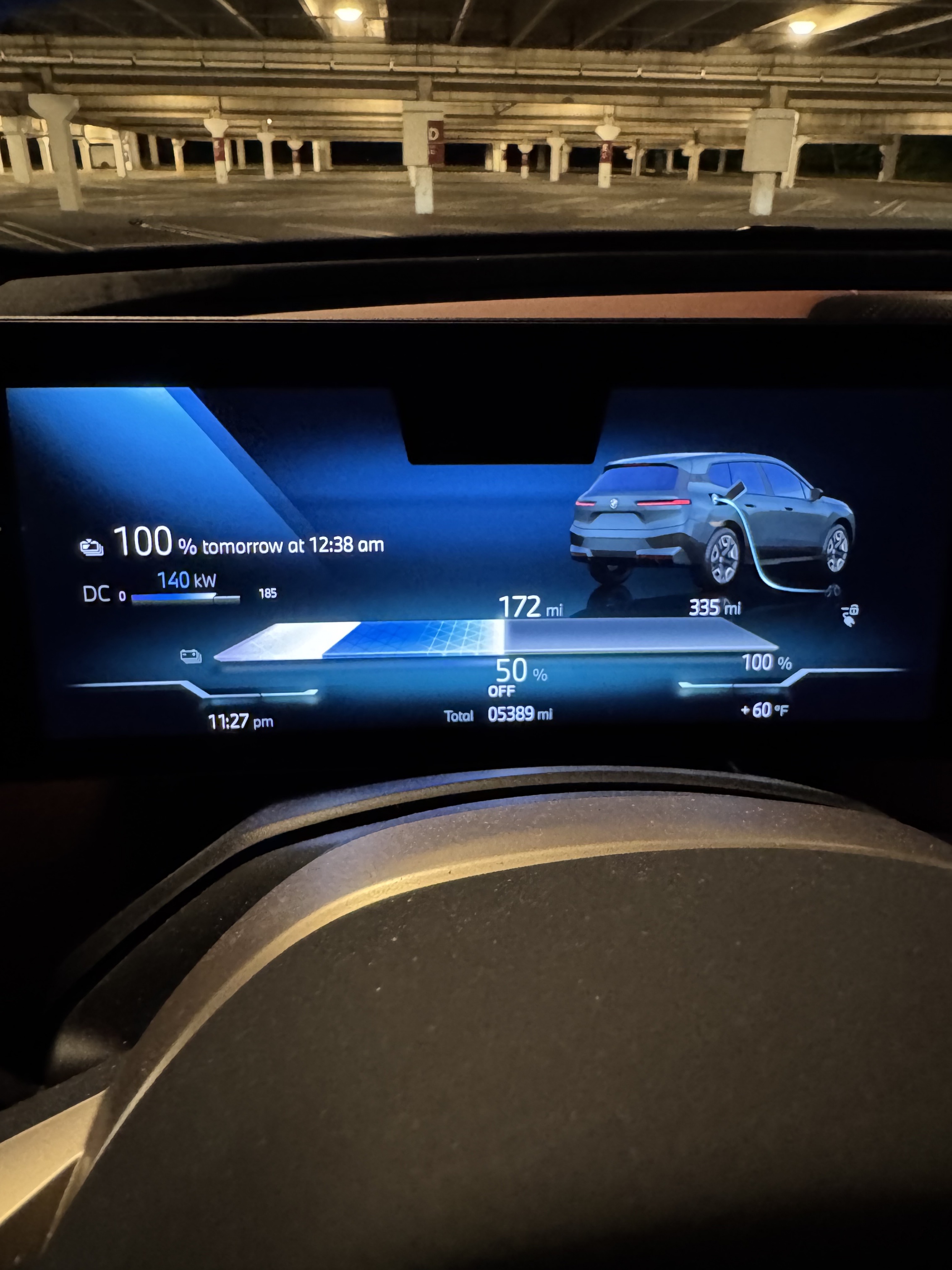

Drives: iX 50

I had a chance to quickly document this observed behavior, and making sure I did nothing but turn the car ‘on’ post-charge, and sure enough, the range indicator dropped from 280mi @ 90% to 276mi. Photos attached showing progression from Starting Charging session, to Charge Ending @90%/280, to waiting prior to turning on car (still shows 90% / 280), to turning on the car which shows the instant drop to 276.

Just charged my car up at EE, using a 350 kW rated charger. My car still shows 180 as the max DC fast charging power. Oddly, when I lookup the documented max rating for my car, it says 195kW….so…. Not sure why my display says 180.

Thank you iXM6025 and LVBMW. It seems like BMW made a change in the software and the max DC charging rate could be based on some kind of calculation based on the charging station parameters.
