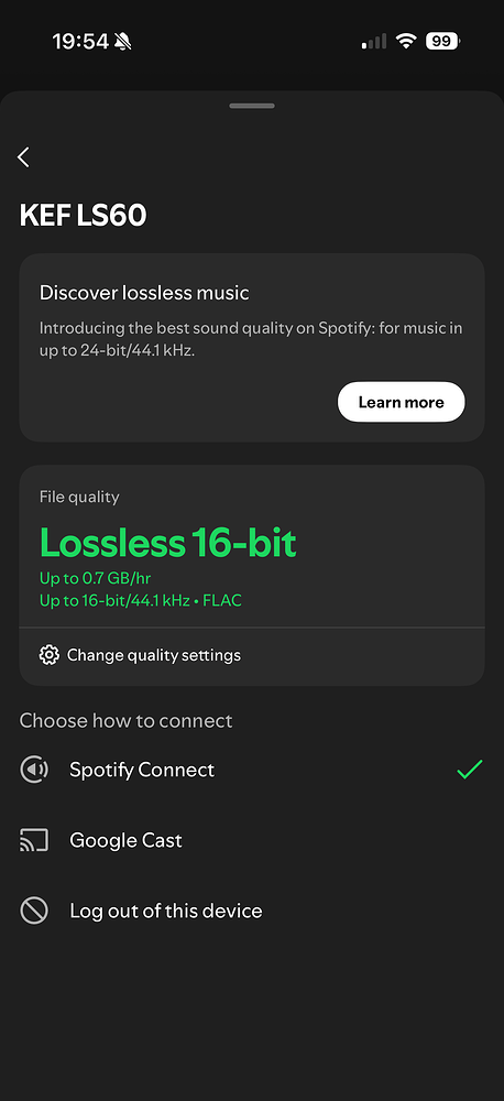

I got a popup message today on my iPhone stating that Spotify lossless audio is available now.
As i have read here multiple times in the forum that the only way to REALLY enjoy the Bowers & Wilkins audio in the iX is through high definition audio files, i am very interested in using spotify lossless audio.
Setting it up on the iPhone (15 Pro) was not difficult. I now set it up so that i use lossless quality through Wifi and for downloaded music, and keep the old automatic setting for mobile internet for now.
Now we get to my problem : i assume the only way to get spotify lossless audio is when i use spotify through my iphone through Carplay. And here i always get the problem that audio will be extremely muted. It is like that 90% of the time.
Does anyone know what is causing Carplay audio to be so extremely muted over and over again. It has always been like that in my car since i have had it (2 years now nearly). It only has functioned normally very rarely.
There must be some cause (maybe some apps that need to be closed or so on the phone, but i do not know which), and i have also read that others also have this issue.
So does anyone know how to solve this ?
The 2nd question is : i assume there is no way to get the Spotify lossless audio through BMW´s build in Spotify app ? Or is there ? The cars integrated Spotify app works through the cars own mobile internet, right ? And there is no setting to change the audio quality i assume ?
Maybe BMW will offer a higher quality audio package with lossless audio streaming at some point, for a extra yearly / monthly fee.

I can surely select lossless audio also for mobile internet, in my spotify app on my iphone. But i do not think this will then also automatically apply to the mobile internet that my BMW uses for the build-in Spotify app. Or does it use my mobile connection through my iphone as well ?
Or will a change in the Spotify settings in my iPhone affect all other devices as well ?
